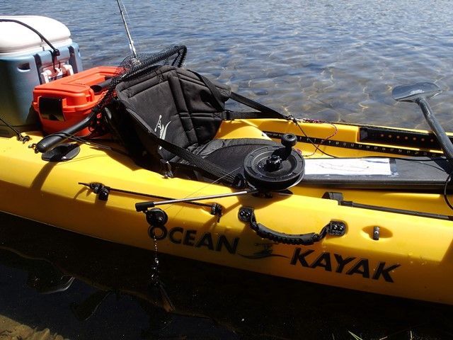

Bracket-mounted Scotty Laketroller downriggers can be mounted on either a side/deck rod holder mount (Part No. 241) or a flush rod holder mount (Part No. 244).  Since Widgeonmangh hasn’t installed his Scotty Laketroller yet, here’s a picture of a Laketroller mounted in a side/deck mount on my 13” Trident.  This downrigger setup is described in detail in http://www.northwestkayakanglers.com/index.php?topic=11486.0 .
Here’s a Laketroller in a side/deck mount which is bolted into a tray on the gunwale of a Hobie Outback.

Thanks Pmmpete.  Great examples.
My kayaks ship today and should be here in 5 business days (another Sunday of yardwork  :'().  I am going to have all the parts here and ready to go so that when it gets here I can mount everything and get out fishing!
My plan will be  to put it basically right where the fish finder is in this picture facing forward. Fish finder battery will have a home under the deck and fish finder on its own ram mount. The only thing I will not know until I get the boat and the downrigger together is if it will be high enough to reach over the front. I believe it will.  Worst case scenario is  I may have to in some way extend it a couple of inches.
