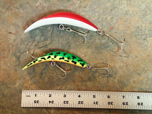

Not sure what the lure actualy looks like or how there made but could you coat it in clear epoxy?
A couple of Flatfish lures are shown below.  I like Dr. Steelheadfisher's idea of coating the inside of the lure with some sealant better than coating the outside.
