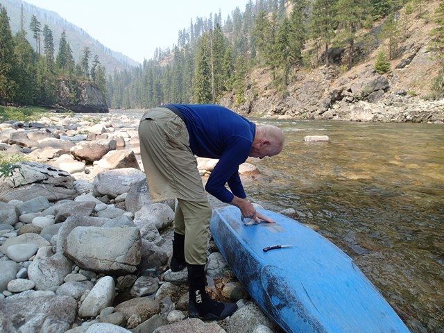

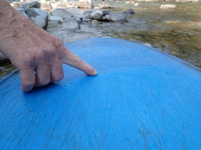

Here is an example of moderate oil canning on the bottom of a whitewater kayak, which developed into a crease, and which then abraded through in the middle of a four day kayak trip.
I did a 9 day whitewater kayak trip on the Rio Atengo in Mexico in a kayak which I had borrowed from Rocky Contos.  This kayak had been hammered by years of Class V kayaking, and its bottom had some serious oil canning with a high point under the seat.  During my trip, two holes developed under the seat.  I had to take the seat out and seal the holes from the inside with raft patch fabric and vinyl glue from my repair kit.  For pictures of that trip, the upper half of which was a first descent and the lower half of which was a second descent, see http://www.sierrarios.org/PagesGeneral/SlideshowLinks.html , Sierra Madre Occidental, Atengo 1-Atengo 3.  I took most of the pictures in that slide show.

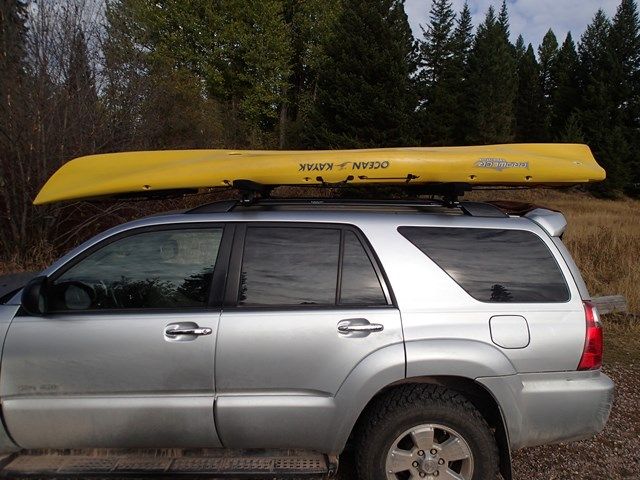

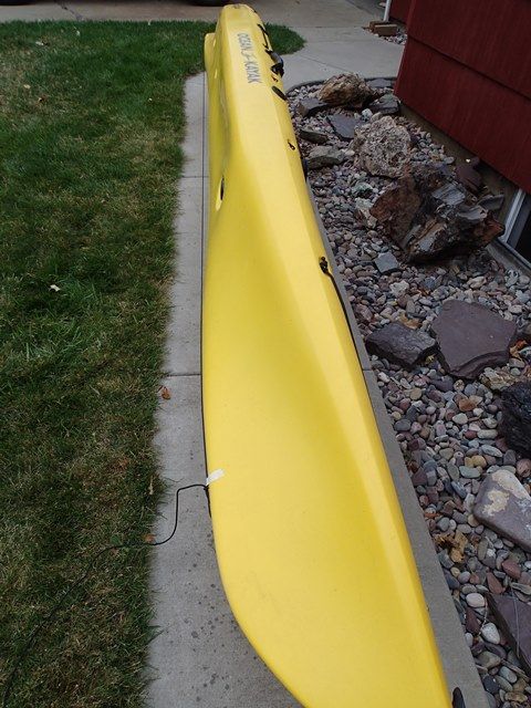

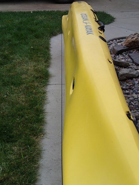

Here is my 13’ Trident.  The negative rocker is obvious even from a distance.
I taped a piece of black cord to the keel to more clearly show the negative rocker:
Polepole, where’s my coke!
The bottom of that boat looks pushed in. Would be interesting to look at a brand new boat out of the mold.

You been snorting it?  Just because your boat has negative rocker doesn't mean it was designed with negative rocker.  No word from the factory yet.
As Fungunnin says, that yak looks pushed in.  Indeed, it looks pushed in in 2 places, very similar to  oil canning caused by saddles or by straps cinched too tightly.  That being said, the racks on that car you have it on don't align to the indentations.  Have you always had it on those particular racks?  Or have you used others.

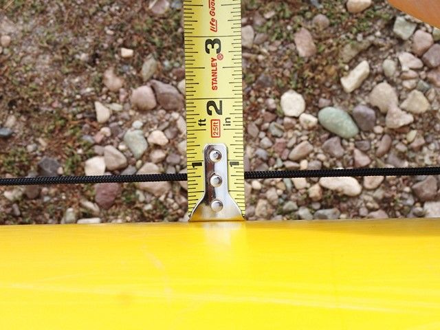

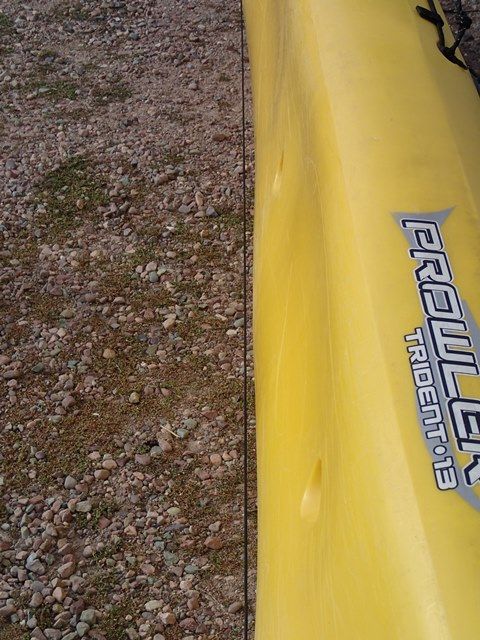

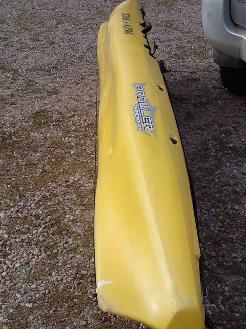

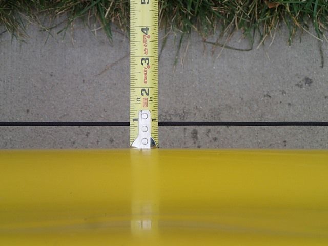

OK ... I'm lazy I don't want to take my kayak down just for pictures. So I took some pictures while it was still hanging. My 2013 Trident 13 does not have negative rocker. The keel runs straight down the boat. My older Prowler 13 looks pushed in, like your boat. The new boat came after I got my Hobie so it has only seen 2 maybe 3 trips as a loaner boat.
Even the string hung below the kayak presses firmly against the hull.
