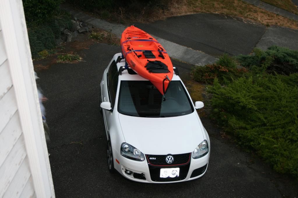

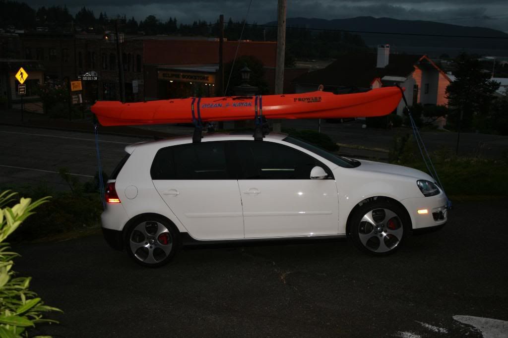

Well...here she is.  What appears to be a brand new 'yak!  Picked her up today, and dropped off the defect.
Excited to get back out on the water, and keep most of it out of the hull!  Picked up some new bass tackle, I think I'm gonna hit the lake and try for some smallies/largies.  Trout season dies off here once all the stockers are pulled out.
Thanks again for the help
