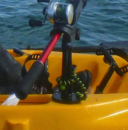

I agree that you are going to probably drill some holes at some point.  No big deal though it is tough to do your first time.  I did pick up a great tip from Coosbayyakker on this board.  He mounted a circular scotty flush mount into one of his front rod holders.  But then its four small screw holes versus an inch plus hole you need to drill for flush mounts.  The foible flush mounts suck.  Even the company rep was very hesitant to recommend them.  I hate them sticking out but I recently replaced my foible flush mount to a pedestal mount now and its rock solid.
Here's an image of the scotty flush mount.

I took Kardinal's advice and used the flush-mount over existing rod tube approach for the 2015.   It works great, and if I ever needed to pull it, it's only 4 small holes - easily filled/patched.   I started with the Scotty rod holders (standard baitcaster style) and have switched up to the Scotty Orca's.   I dont have many fishing days with the Orcas (bought in Oct.) so it's mostly dry-testing, but they seem quite similar to the Folbes, perhaps a bit heftier, and are good build quality.    I also bought the scotty long posts (not the extensions, the ones you replace the short posts on the stock orca's) and now they sit up about 10",6 to 7" higher than the standard.    Better clearance for my feet/drive when running it across the kayak right to left.
I like the flush/deck mount as it doesnt hang up on my rack bars when loading/unloading.   For same reason I installed the ram ball mount inside the right side channel, just forward of the rt side drink holder.   I had to cut about 1cm off the side of the ball mount disc to get it to fit well, but it keeps in low-profile as well.   Short segment of gear track in those channels would likely work well, would like to hear from someone with a 2015 that rigged that way and see some pics.
PS - you'll like the adjustability of the new seat.   We now have kayak inequality in my household, sounds evil but I am hoping Susan wont want to fish most days and I'll get to use her 2015 more than she does....
Note the last pic shows the FF install on the near side of the scotty flush mount, but does NOT show the new Orca Rod holders.
