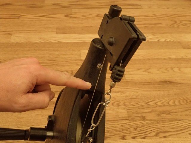

I will take a photo tomorrow showing the area to be enlarged to prevent the cable rubbing. When you shorten the arm you change the geometry of the DR causing the cable to rub where it exits the main body of the DR on its way to the pulley.

Are you referring to the round "barrel" the arm fits into because when the counter pulley is too close the line rubs there?
If you shorten the boom of a Cannon Lake-troll, here's the point where the cable or braided line can rub on the throat of the downrigger's body.  The more cable or line you let out, the closer it comes to this point.
Thank you pmmpete, I wasn't shure how to explain this without a photo.
Thanks pmmpete. I was thinking the rub point was going to be near the pulley. Thanks for the point about compensating for diminishing spool diameter as you drop the weight. I guess with the counter working from the pulley and not the main spool like my Uni-troll you could actually add some backing under the cable/braid to increase the spool diameter since there is more than enough capacity on the spool for 150-200 ft of braid. That would also mean fewer turns for bringing up the weight too.
