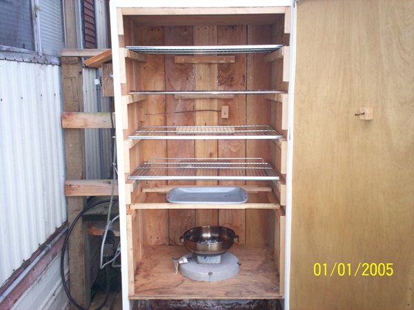

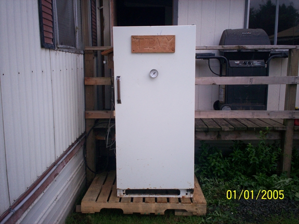

Meet Tiny, my smoker, cedar lined: It has ten 3/8ths inch holes near the top on each side and a couple holes in the bottom under the heat element to draw in air. I can plug the holes for more or less air. It's nice and smokey smelling now, the pics were from when it was new. I use Apple and Alder mostly for fish and cheese and mesquite for beef.

That looks like one sweet smoking machine.

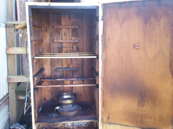

Yea, it turned out awesome!! Can smoke major poundage of meat. Here it is after a bunch of smoking, too bad there's not smellapic, it smells so good...
CBY, unless you share - your neighbors must really hate you for all that smellocity emanation .  ;D
I'm pretty sure my neighbors have never eaten as much fish as they have in the last year and a half... 8)
