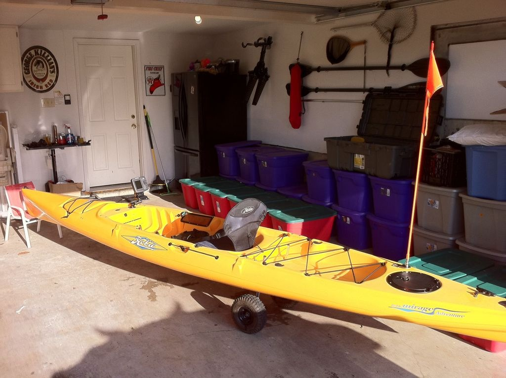

So here is a play by play on the rigging of my new Hobie Adventure Kayak.

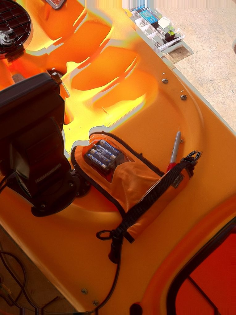

I purchased a Hummingbird 385 and a Hobie fish finder install kit and installed the fish finder today.

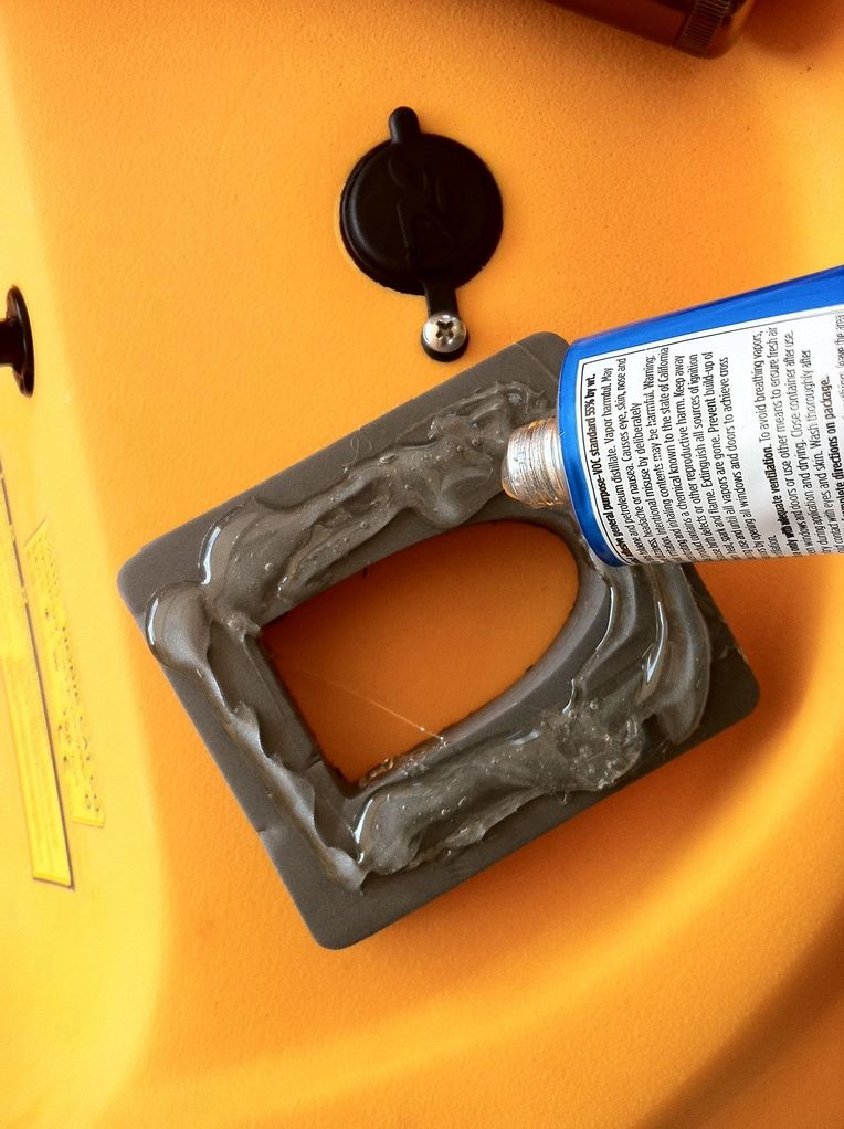

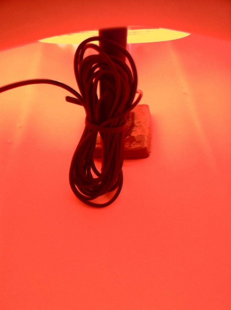

I marine gooped the foam brick to the bottom of the boat behind the sail fixture after sanding and cleaning the area.  I duct tapped it down to hold it in place.
I let this dry for about two hours while I installed the mount and safety flag.

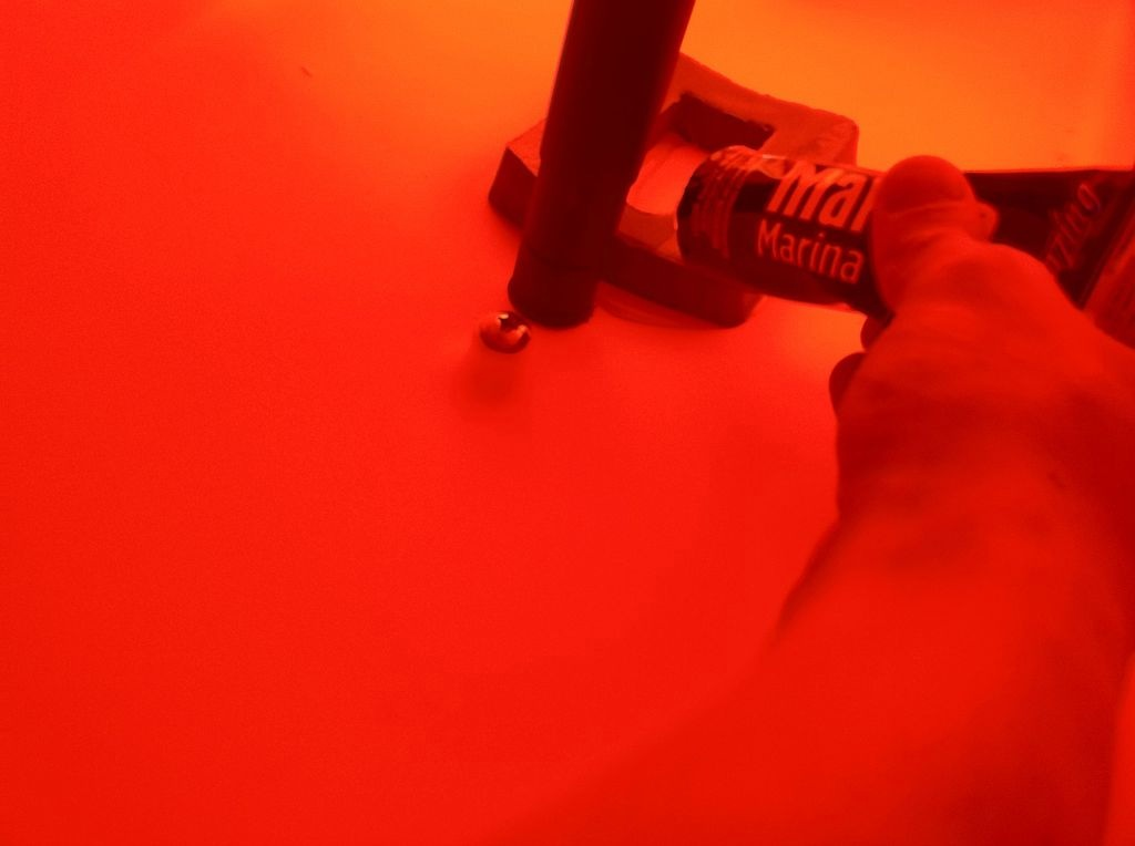

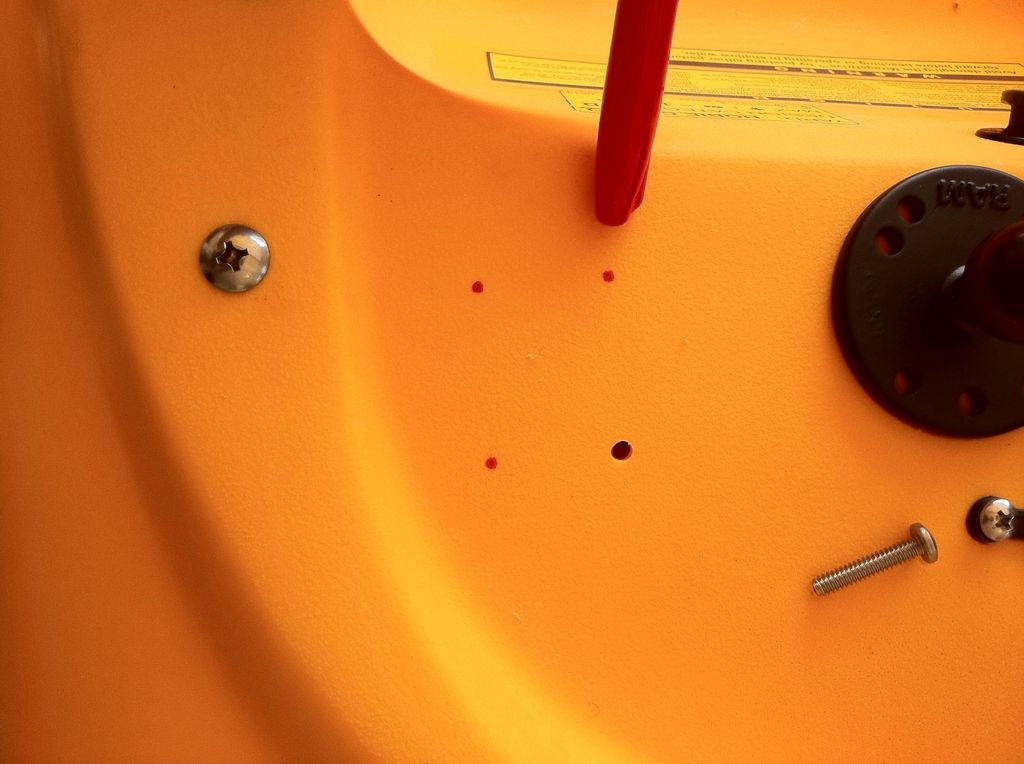

I purchased a ram mount because I want the fish finder to be adjustable and up high so I can see it over the pedals.  Here I marked the place for the screws, and began drilling.  I placed it to the right and not center because I am going to install a Scotty Rocket mount to the left.

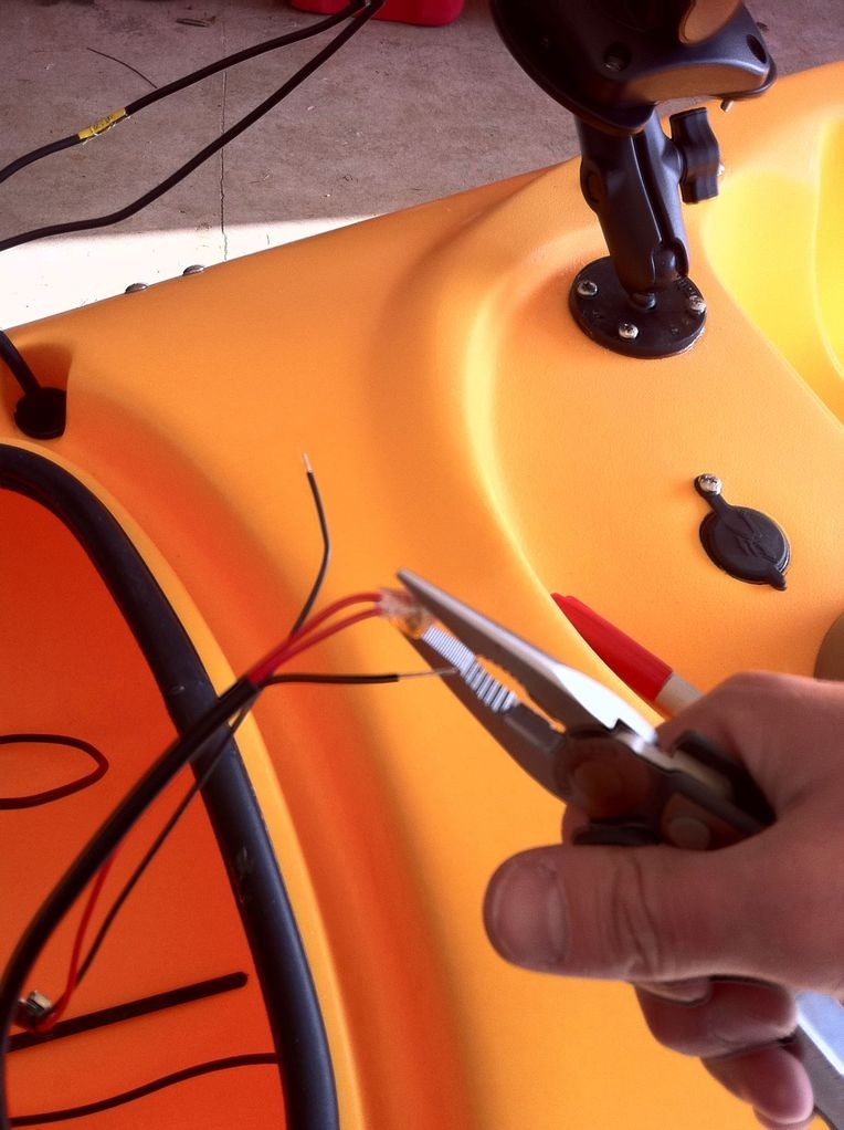

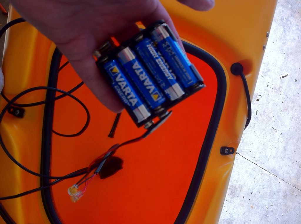

I just did the double A battery pack for now, if it does not last long enough I will switch it out later with a larger pack.
After 2 hours and two beers I pulled the tape off of the foam puck and filled it with a 1/2 inch of marine goop.  Insert tranducer.  Zip tie extra line.  Bobs your uncle.
I did not drill a hole for the power supply and tranducer cords on this yak like i did on my OC prowler due to the convienance of just pulling the lines through the hatch.  I will probably change my mind, but I am trying to keep the adventure simple so I can run it out for sport as well as fishing.  Again I will probably change my mind...
So just a flag and fish finder so far waiting on the rod holder, and I will deffinitly get rod extenders.  Also using a milk crate for salt water (rod holders on the way) and a yakpak III for fresh water.

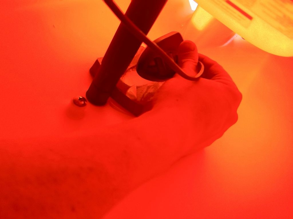

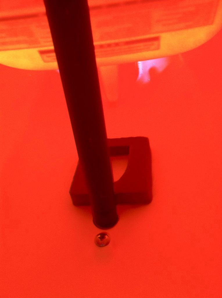

I installed a round flush Scotty mount mount at the front of the yak, primarily to get it out of the way when I am not using it.  I installed the standard flush mount on the left side above the rudder pull cord as well.  This turned out to be a lot of work, I used a part of a pool noodle to hold the cords back, I wont lie I was paranoid about hitting the cords.   Getting to the bolts was a lot of work under the mount, not my favorite install but it went in clean.
I purchased a new battery today as well, the 8X AA did not last the entire Ling Cod trip with Fishnut so I obviously need to upgrade.  Thing about a back hatch install after seeing Demonicks post a while back.
