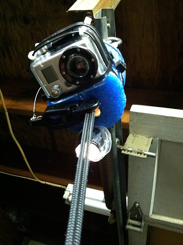

This was a fun little project.  Pixster inspired me with his underwater video stuff!
Here's the notes I attached to the video.  There's a pic of the rig I used below.
I really wanted to see the underwater structure of one of my favorite spots to fish. I also wanted to know more about how a lingcod strikes a live greenling, and what he does after he takes it in his mouth.
So, I surrounded up a GoPro camera with some bouyant material (a pool noodle) to keep it above the action), then slid it on a doubled over section of anchor line. Had a knot keeping it in place in back, and a downrigger clip in front (so it could be adjusted up and down the line). I then took the back of that rig and tied it onto my 65-lb mainline. Really can't get stronger than that! On the front end I tied a section of 25lb test "safety" line, so that if a hook or sinker gets snagged, I can easily pull off, breaking the 25lb test and recovering the camera rig. Below the safety like is an 8oz ball singer that balanced out the bouyant camera nicely. And below that - a 80# leader with 2 10/0 barbless hooks for my 12" greenling bait.
Got alot of hookups, maybe 7 or 8, but only managed to get one to the boat. It was good times, especially learning about the habitat of the spot I fish so frequently. I spent hours looking at the footage.
Not sure why the main camera is aimed at my chin. That kinda bums me out. But whatever.
Sorry a bout the wind noise. The Playsport mic sucks. I gotta try to find a fix for that.
(didn't end up going with the flashlight - there is enough natural light in daytime down to 40 ft.)
