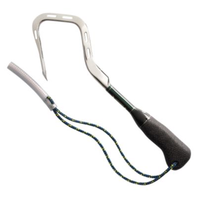

What about a hybrid of sorts? (Shark-poon) Take a harpoon head and fix it to a retrofitted shark hook or bent stainless rod.
Basically using an upward motion of inserting the harpoon instead of downward.
Would that be helpful or be combining the worst of both worlds? (I'd guess it's been tried before)
I like reading about this discussion btw. Even if I never get a chance to spear a halibut, it's great to think about it. Those few seconds where a big snag makes me hope for a monster 'but and pumps the adrenaline while reefing on the rod. Having a Shark-poon nearby while I determine if the "headshakes" are just choppy swell may help me feel better about myself.

I'm not thinking of a flying gaff either. More like a small gaff with a harpoon tip.
This one looks BA:
just dull the tip and insert your regular harpoon setup.
