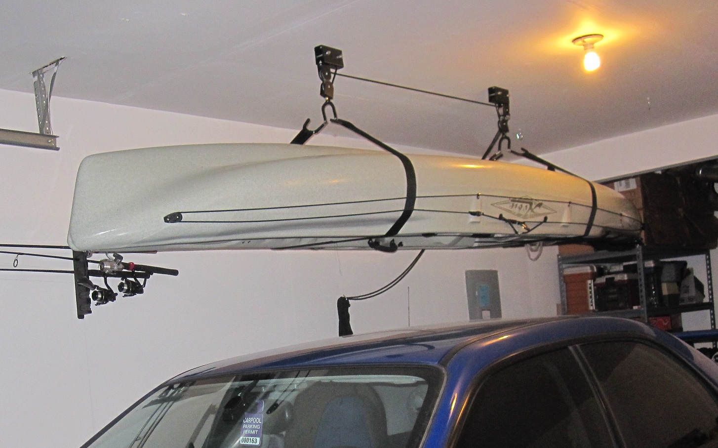

I need to store mine in the house, most of it in the living room. I plan to have this one on its side, bottom to the wall. My plan is to use 2  2" web straps around it, then some leftover pulleys to raise it to the ceiling. I might try to do the same thing but alter it by raising it top to the top, but not sure if this is appropriate considering hull flexing. I think i can make quite an expensive debacle of this with a beer or 2 and a few ill advised imbellishments.
If you want to hoist them up to the ceiling, you could get these from Costco for $27.99
Or these from Harbor Freight.  I recently picked up the Harbor Freight set.  Looks identical, but much less expensive and different packaging (also was not a 2 pack).  It was $9.99.   It also says it can only hold 50 pounds.
They say the capacity is 50 pounds.  However, it is designed to screw into the rafters in two spots and the 10 provided screws are cheap (kind of soft).  They stripped almost instantly and a few broke.   I bought a set a long time ago and there has been a kayak hanging on them for years.  However, I screwed mine to a 2X4 with as many screws as there were holes(20).  I also used stronger screws.  The 2X4 was screwed across 3 or 4 rafters using 1/4 inch lag bolts.  The rope I used is what came with the hoist (not of good quality), but you could replace it with better rope.  As a safety precaution, I have two pairs of hooks screwed into the rafters near the bow and stern.  I put the tarp straps I use for holding the boat to the roof rack of the car on these hooks and tighten them up so the boat hangs above it from the hoist, but most weight is on the straps.  The straps can completely support the boat if the roe were to break.

all you Harken Hoister boosters, get on Squidgirl to post up picks of the hoist system she made for the two tridents at the house. and there isnt a 50lb limit using the stuff she used.

I was going use the hoist system bluewrxo2 has. I have found the kit at Lowes and Fredmyer as well. After reading some reviews on it, some complain the straps are too long, rope is cheap, and locking/latch system requires weird angle to unlock. I am going with something like this guy's. I need it to be able to suck up close (unlike his) to the ceiling to clear the top above the garage door. Shouldn't be hard to find quality parts.

++ on the bicycle hoist system. It's rated at 50lbs, but I have my Hobie Outback hanging on it. I installed it similar to what Craig described. I use 4" webbing from Seattle Fabrics and hang the Outback upside down. It was supposed to be a "temporary" solution until I found a more reliable system. A year later, I have two 90lb Harken's system ready to be installed as soon as I get my 2nd kayak.
